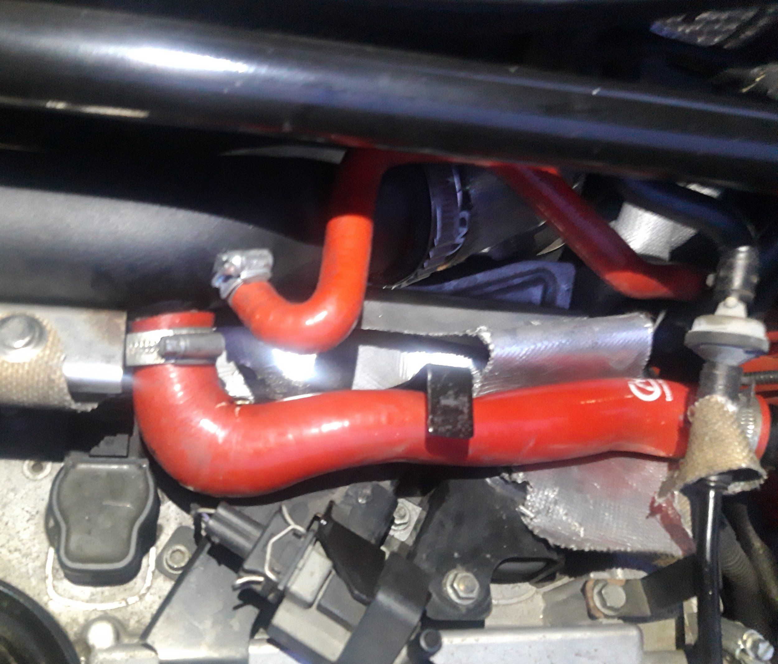

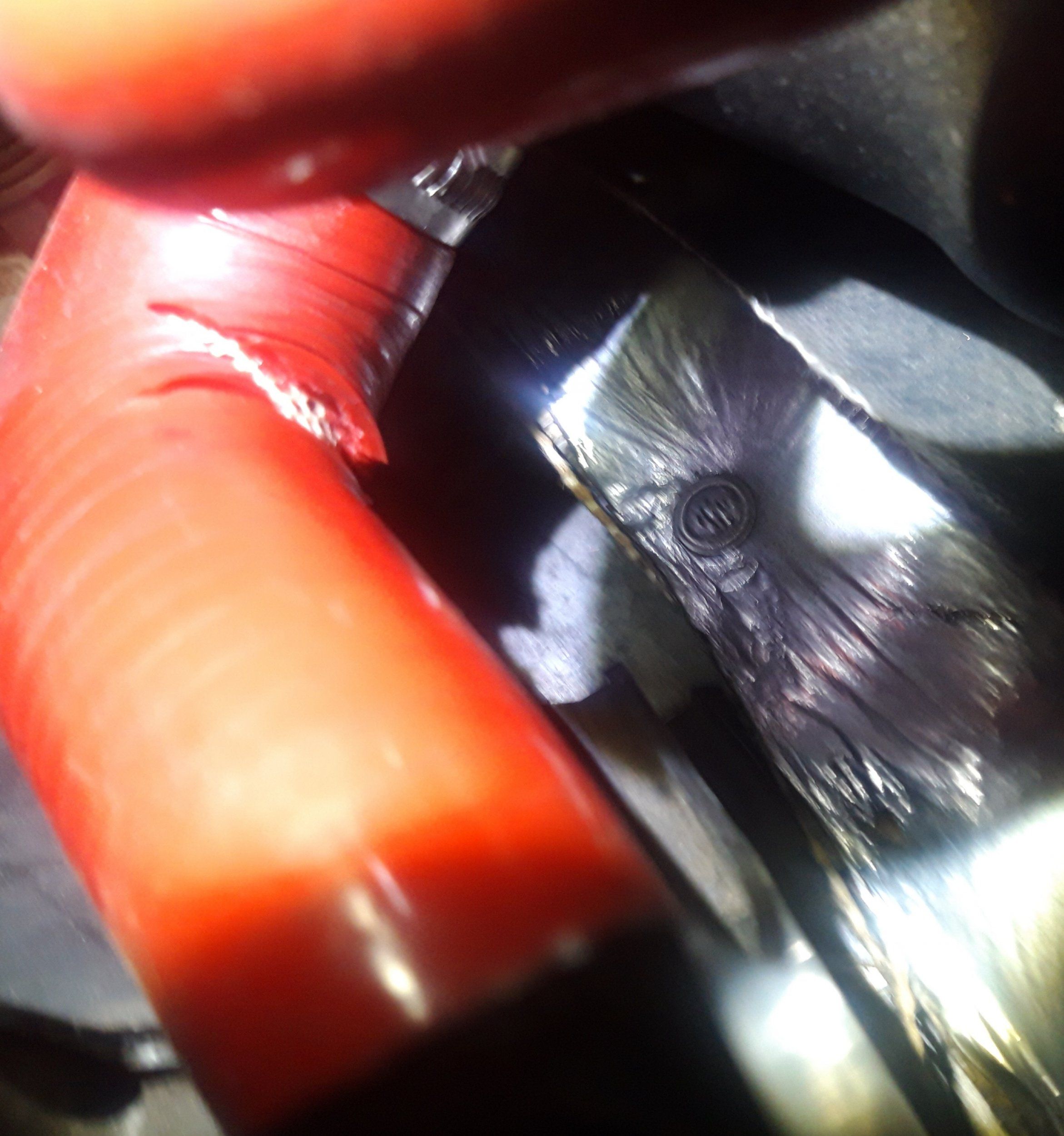

Fiddling about under the bonnet today, i noticed this.
Its holding pressure for now and just ordered a new one off Ebay.
Hope they pull their thumbs out and get it to me asap.
Gentle driving till it gets here.
should of not done that wtf look new as well , is it a cheap one or branded ? lucky you looked and seen it , happened to me a few years ago
with the N57 the middle pipe looked odd i touched it and the dam pipe holder on the n57 broke off it looked glued as well.
this is worth keeping handy for pipe repairs https://www.screwfix.com/p/self-ama...leGuDFHfKjzSJUVgv6YaAntDEALw_wcB&gclsrc=aw.ds
got it on a breather pipe and fuel pipe that's scuffed then used insulating tape over the top , good as new now lol
Reactions: Rich.T

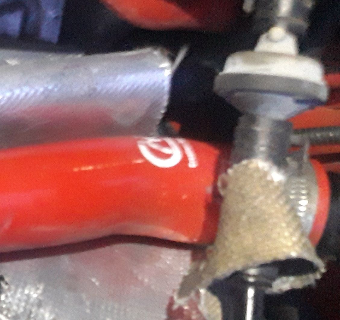

There were a few red hoses on the car when i got it and i carried on the theme. Ive looked through my purchasing history for parts on this car and i cant find anything to say i bought it. But i cant be sure. It maybe something i brought or it may have been on the car when i got it.
Ive got a Forge one coming for it. Ive never (knowingly) bought cheap quality parts for my cars.
Not sure what make is on there. Ill take a look when i either A) Replace it B) Break down.
Here a pic of the emblem on it...
Reactions: Nam-uk
That looks like a Creations Motorsport one. I have a forge one too and there isn't alot of difference in them.
That failure mght have been caused by the hose being under tension. Take a look at my old post linked below. I found the hard pipe to DV connection too long a stretch when I installed a Badger 5 TIP. I ended up doing this - https://www.seatcupra.net/forums/threads/what-have-you-done-to-your-car-today.323941/post-4970041
Great, thanks for the info.
I'll have a look at that. I didn't notice that it was under any tension. But if the new one is, ill do the mod you have done 👍

Im hoping itll hold together for a couple of days till the new one comes.
It looks like its just the outer coating thats come off so hopefully still structurally sound.
Will still take it easy though.
if its that brand what they said above no way the hose should fail like that especially with them custom made, looks like its crumbled/broke down weird
