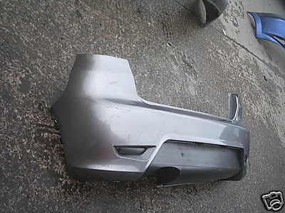

I bought this Cupra rear bumper off ebay and set about smoothing it and playing with a few ideas for a one off custom exhaust.

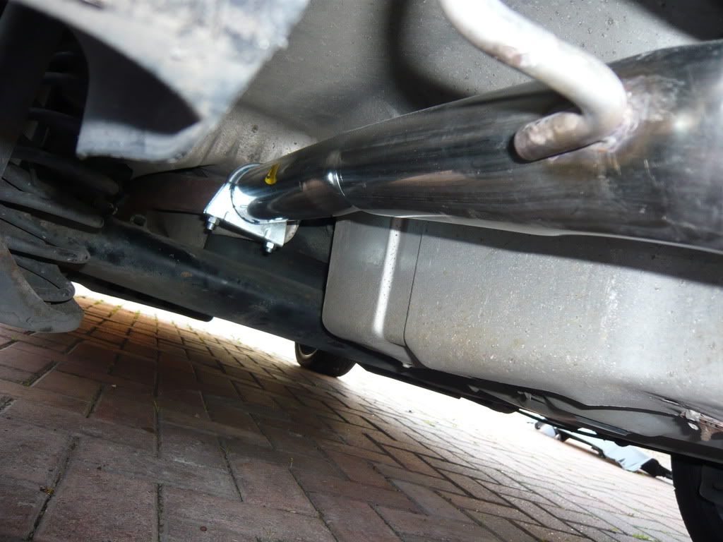

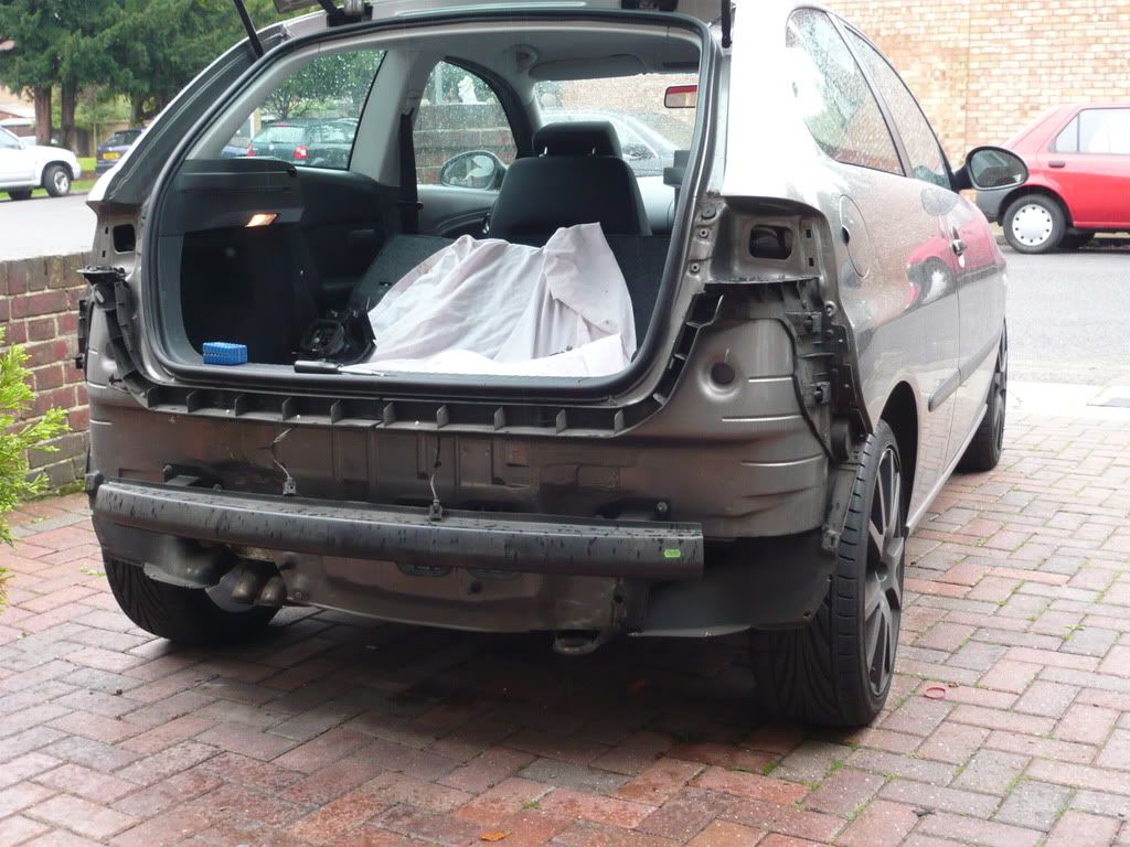

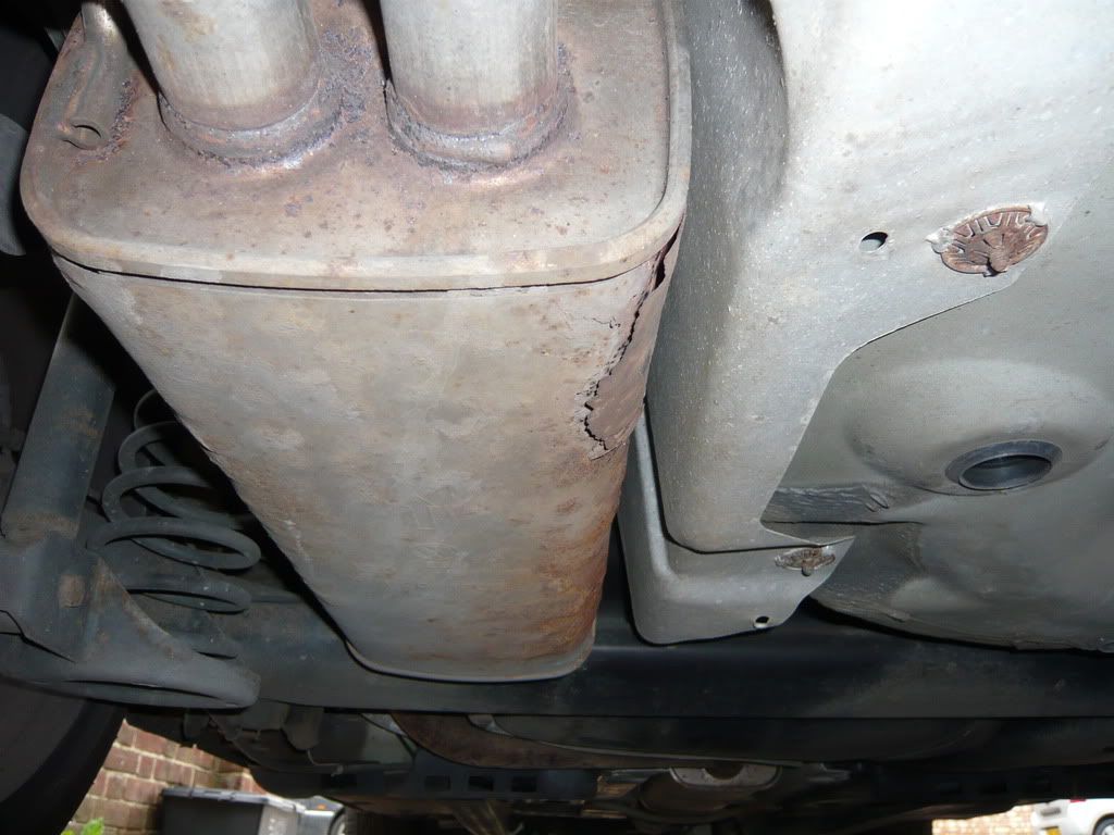

Here are a few pics of the old system

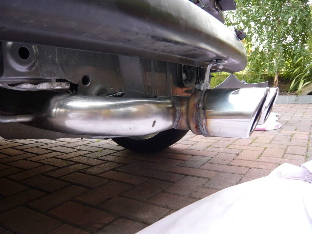

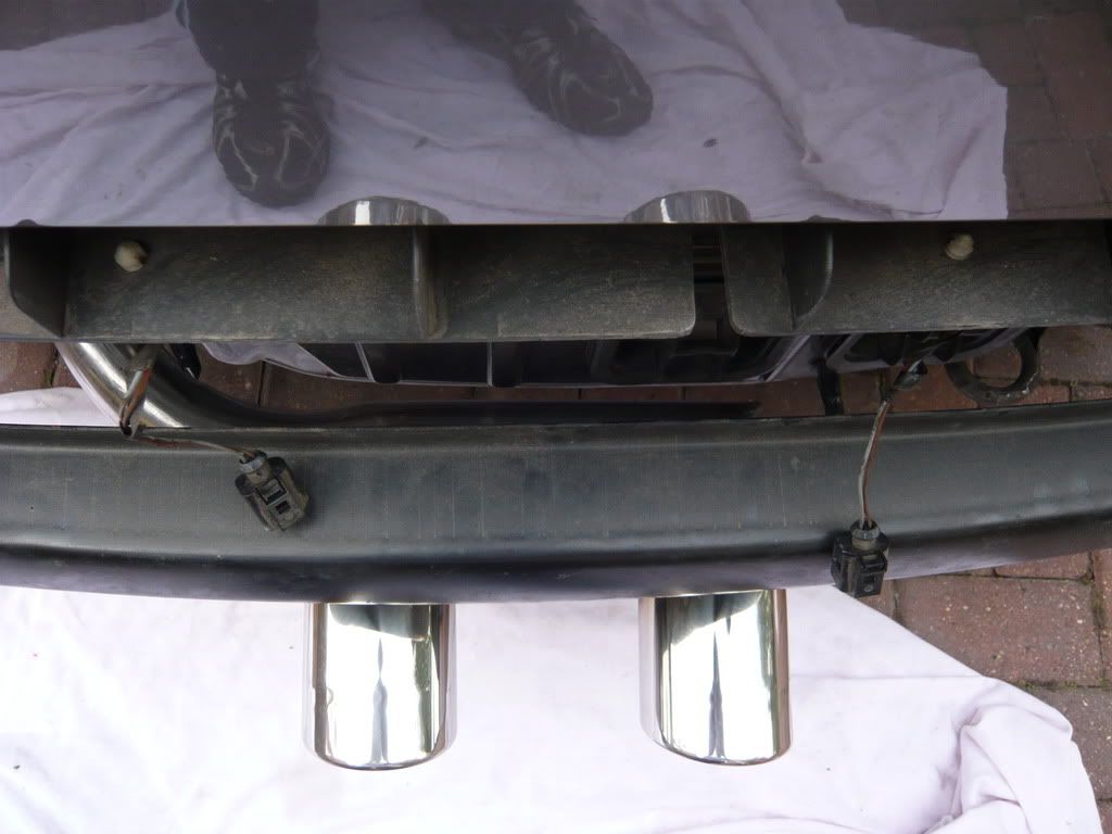

And the shiny new one complete with 3.5” slash cut tips

I needed to do a lot of work to get the rear valance to fit around the new pipes. I also had to re-align the new system as it was sitting too low.
Before
After
It came out really well, although it is a bit shiny!

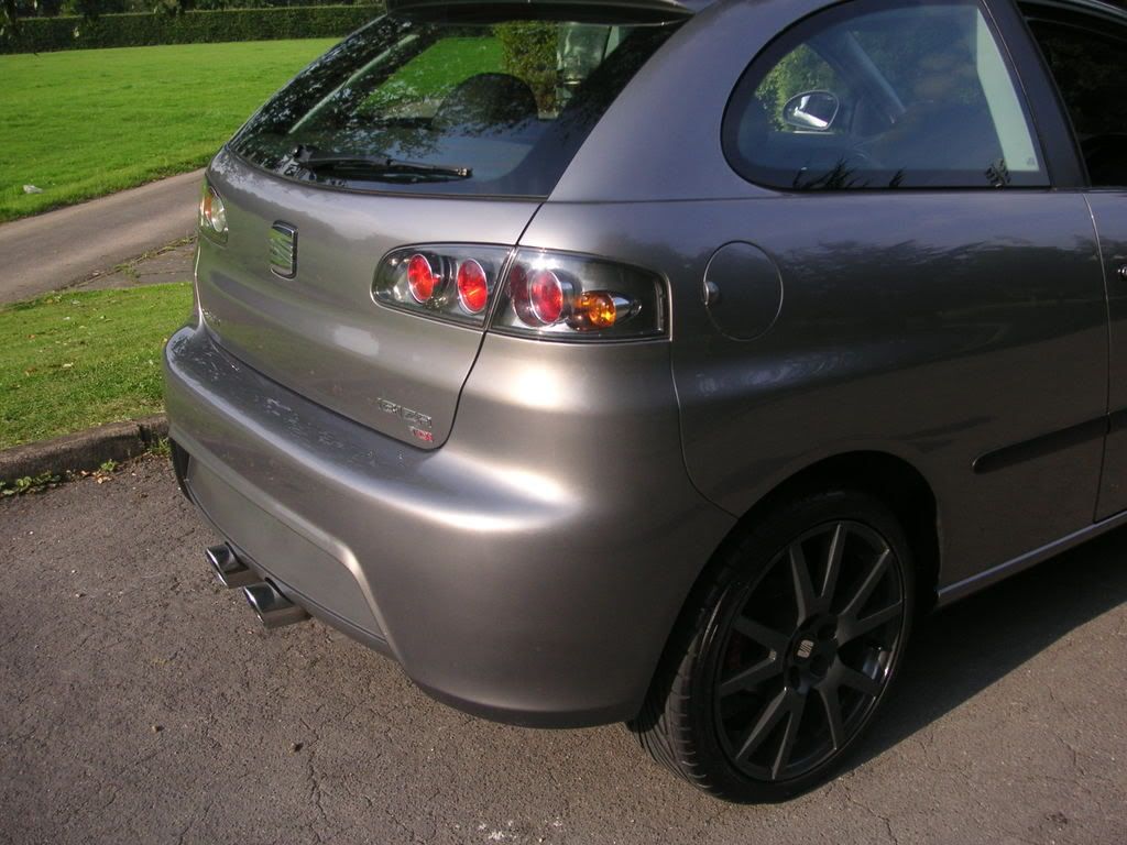

Here are some sunny shots that I took today after giving the car a wash n wax,
I’m really pleased with the way the bumper and exhaust have turned out…. What do you think? :D

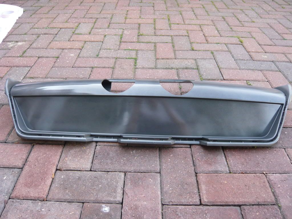

How did you go about smoothing the original cutout? Abit of plasitc welding and fibreglass?
Yup I plastic welded a patch in, fibre glassed it from behind for some strength and then used fibre glass filler to even up the outside

It took quite a while to get it right. Completely forgot about progress pics! But here's what I did,
I firstly cut out the exhaust tunnel part and tried to weld in a piece the same size as the cut out. This didn't work so I ended up welding some overlapping plastic strips on the inside, kinda like a skeleton. I then welded the patch to the skeleton and melted all the sides into each other. To make it more rigid and less prone to cracking I fibre glassed the area behind and then evened up the front with fibreglass filler. To finish it off I used a skim of normal body filler.
Painting it was the hard part as you can't buy the colour anywhere. I used the same paint that I used to paint my wheels (hurricane grey) as a base coat. I then lightly dusted metallic silver over the whole piece. The colour match is spot on but it is a bit shiny
