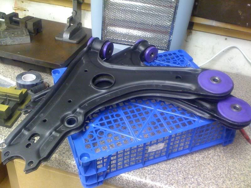

Oh, by the way fitting the rear wishbone bolts when you have the powerflex washers and collet things
is bloody hard work. Because the new collect does'nt allow any play in the bolt the subframe has to line
up perfectly and is was slightly offset on boths sides on mine. I think this is due to the lacke of collets
on the standard bushes allowing the bolt to pull the subframe about under load. Anyway it took far too
long.
Got the bolts out ok though in the first place, lots of heat and work them back and forwards did the trick.
