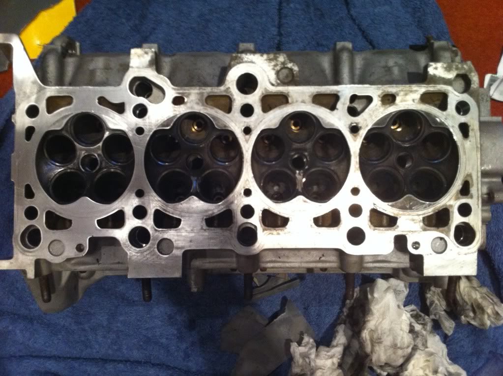

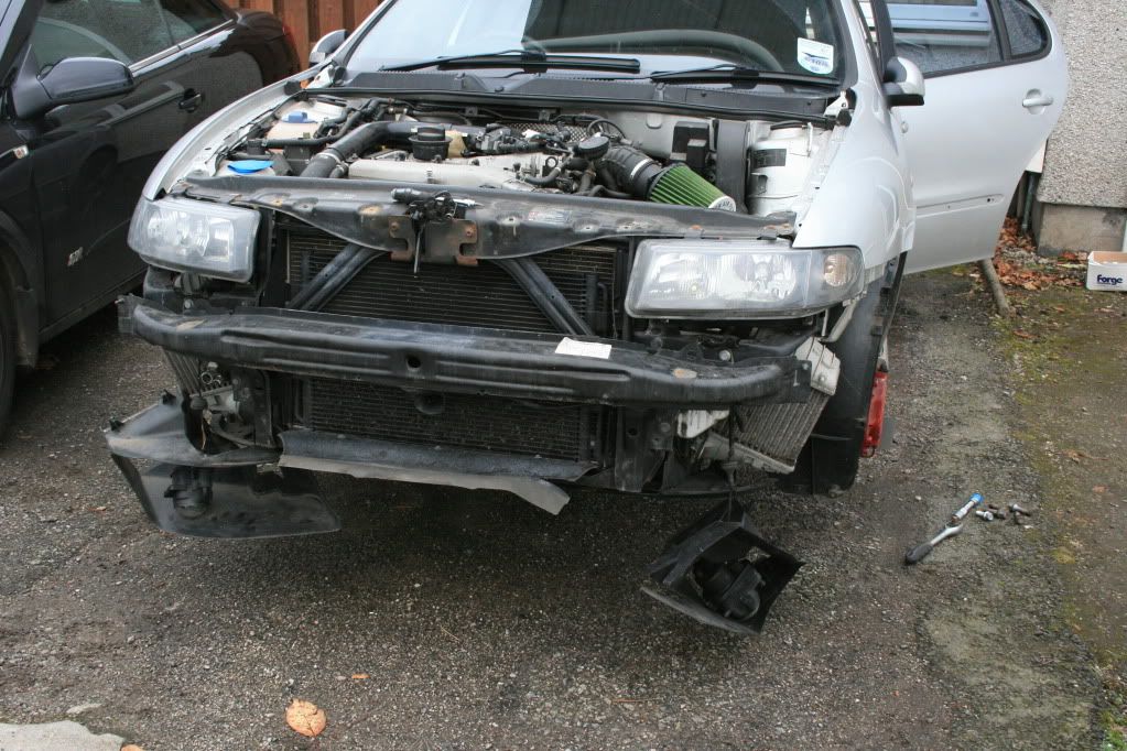

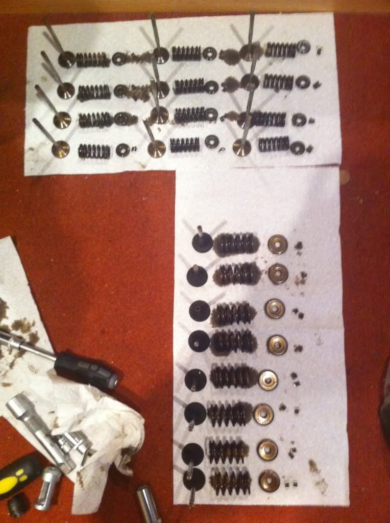

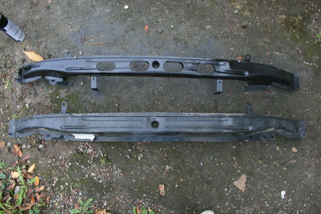

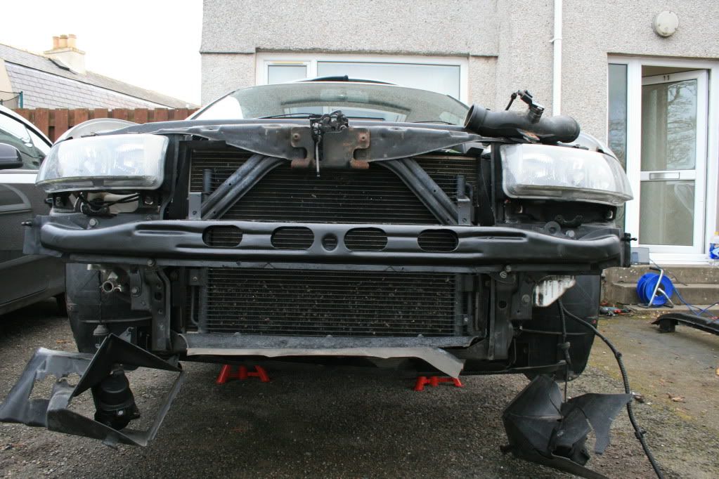

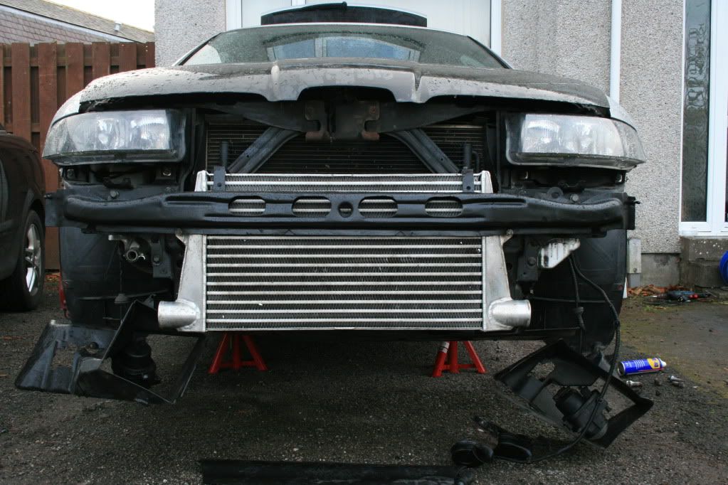

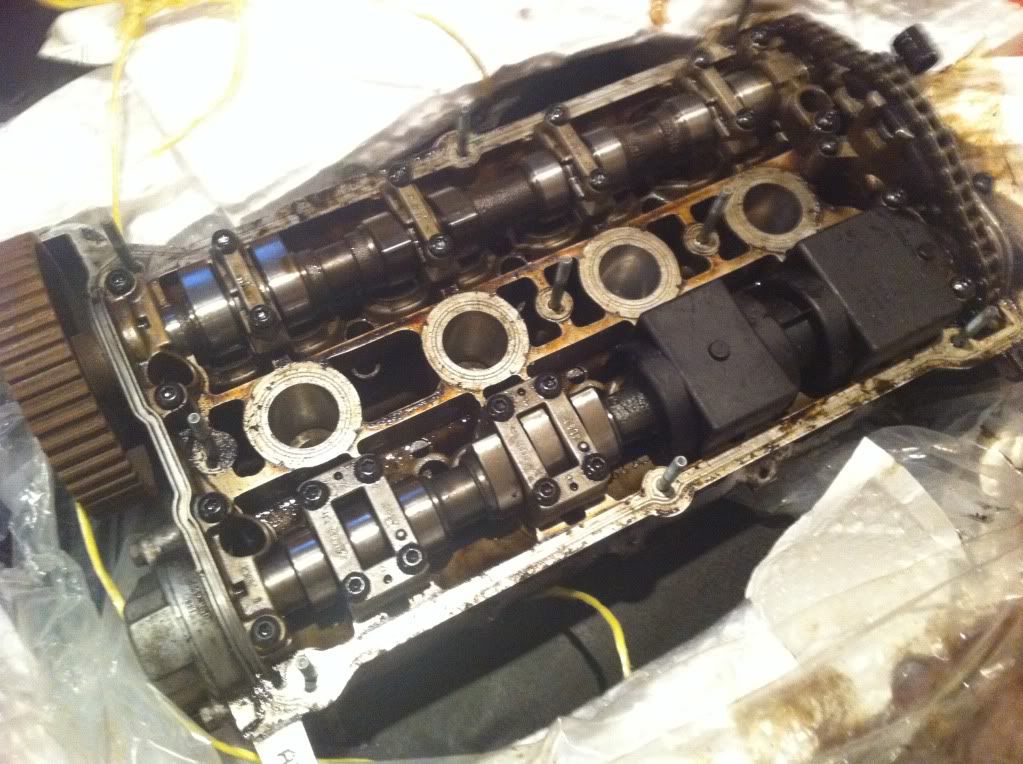

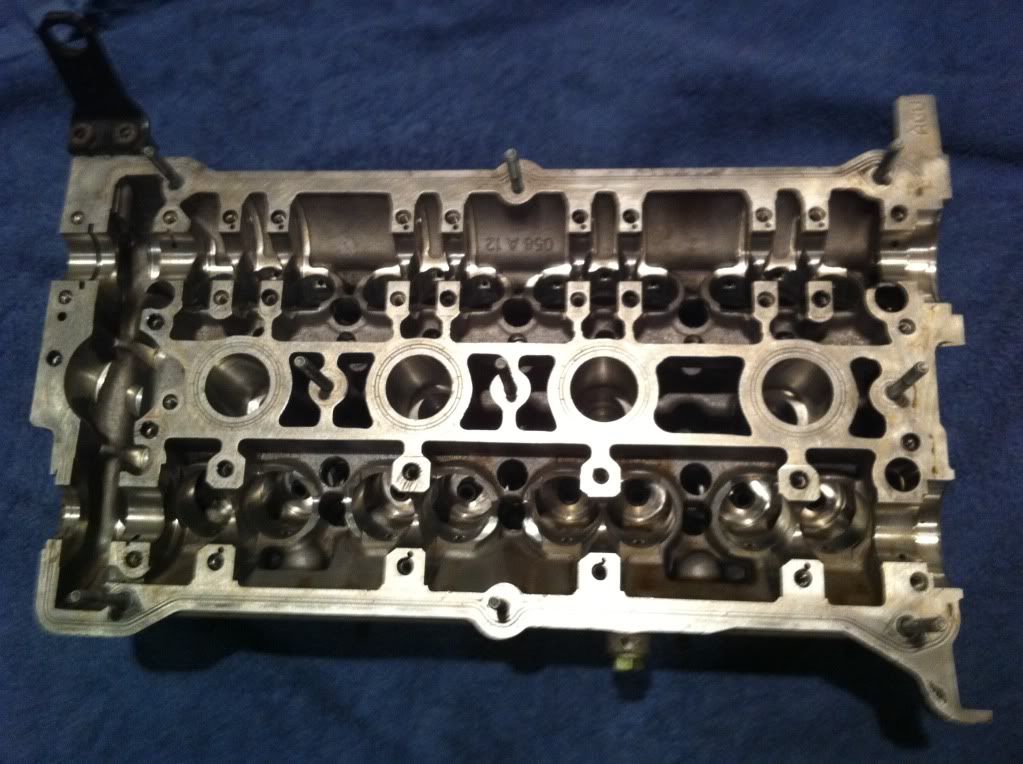

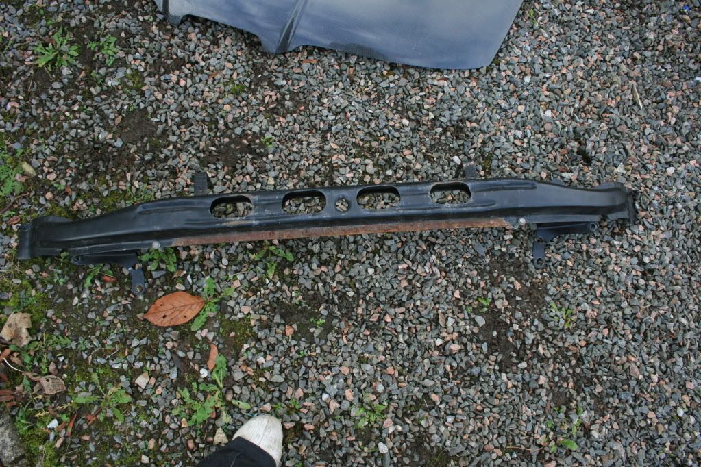

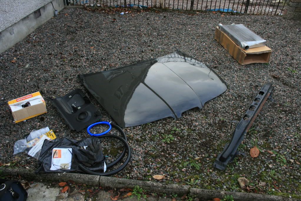

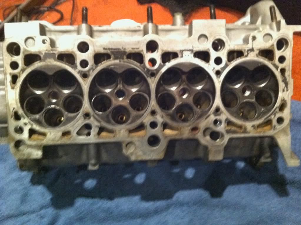

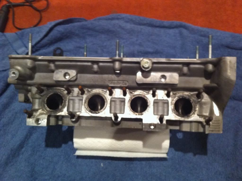

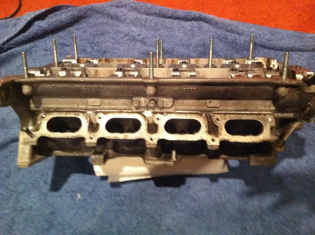

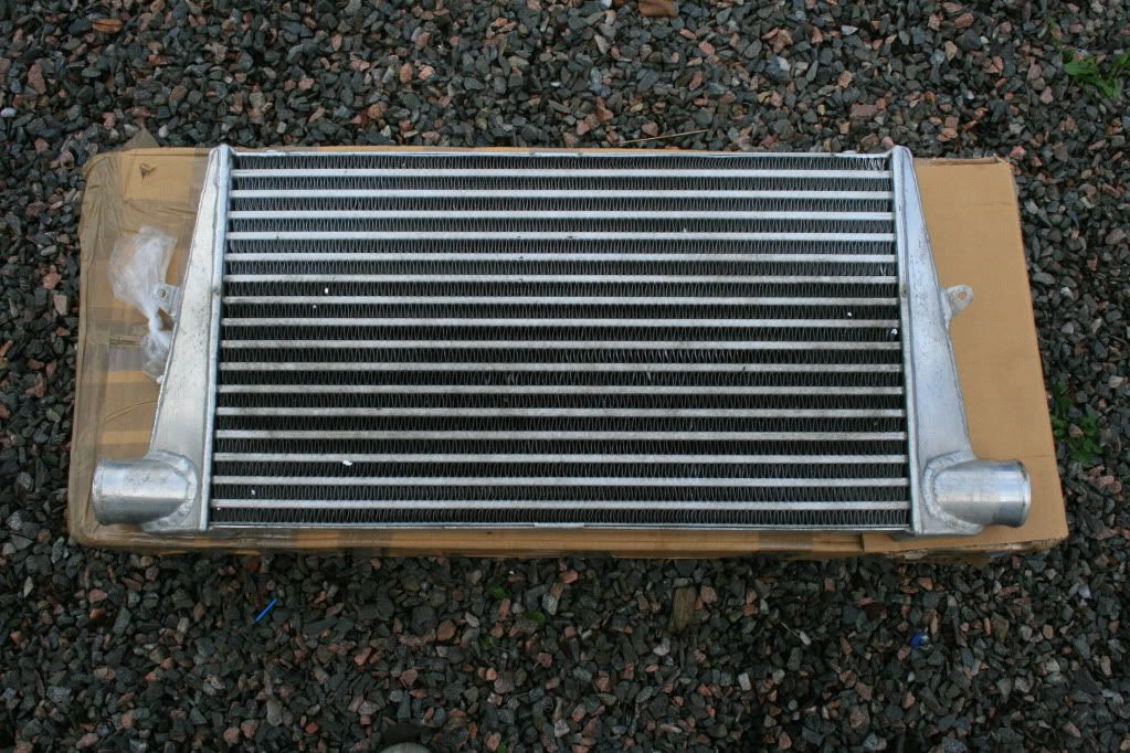

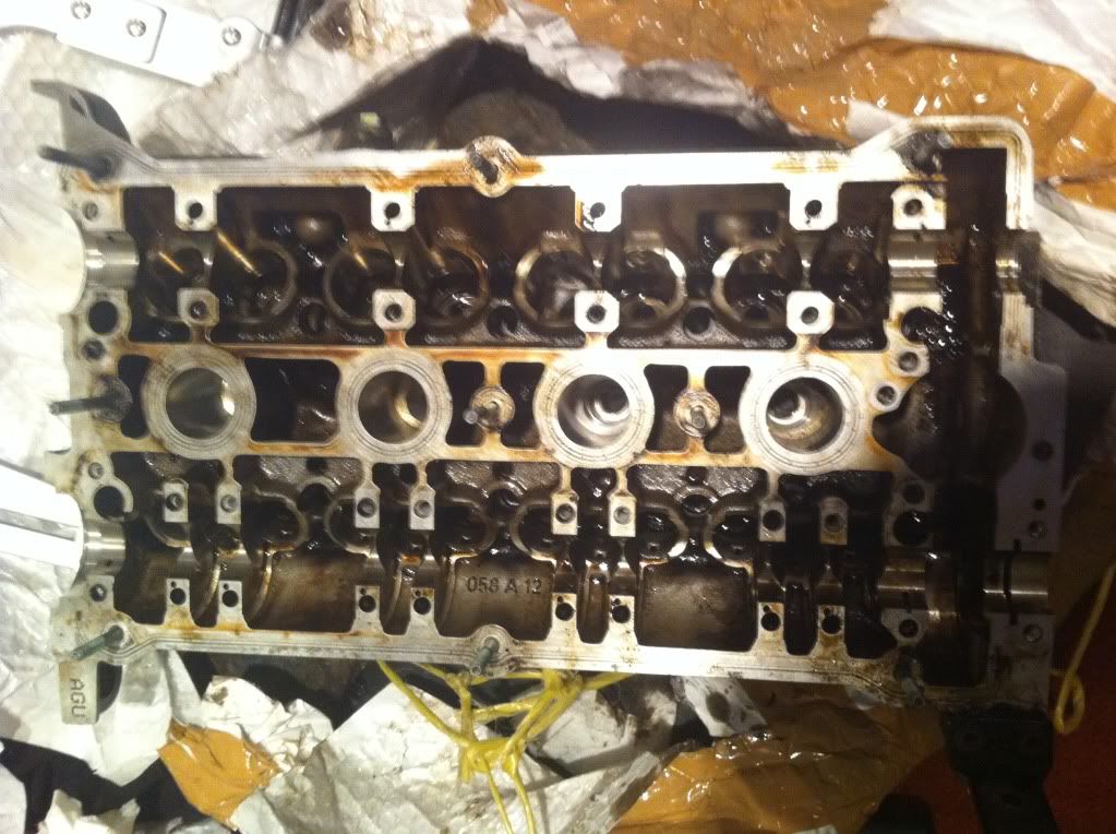

Right update time last weekend i obviously put my forge big race intercooler on so pics now below. Ive sold the garrett to a member on here have deposit and rest shall be next week. Speaking to someone in work whilst doing a course i was informed of a cleaner that i could put the agu head in so stripped and cleaned it came out looking great but still some grime so started to clean this by hand. Valve chamber is suited up so gonna sand with fine grade as to not take much off and effect performance. Will put valves in whilst doing this as so not to damage seats. Then shall polish the intake ports, wont be porting unless i should do something other than just polish but thats the plan anyway.
Pics below and hope you enjoy
Mark
