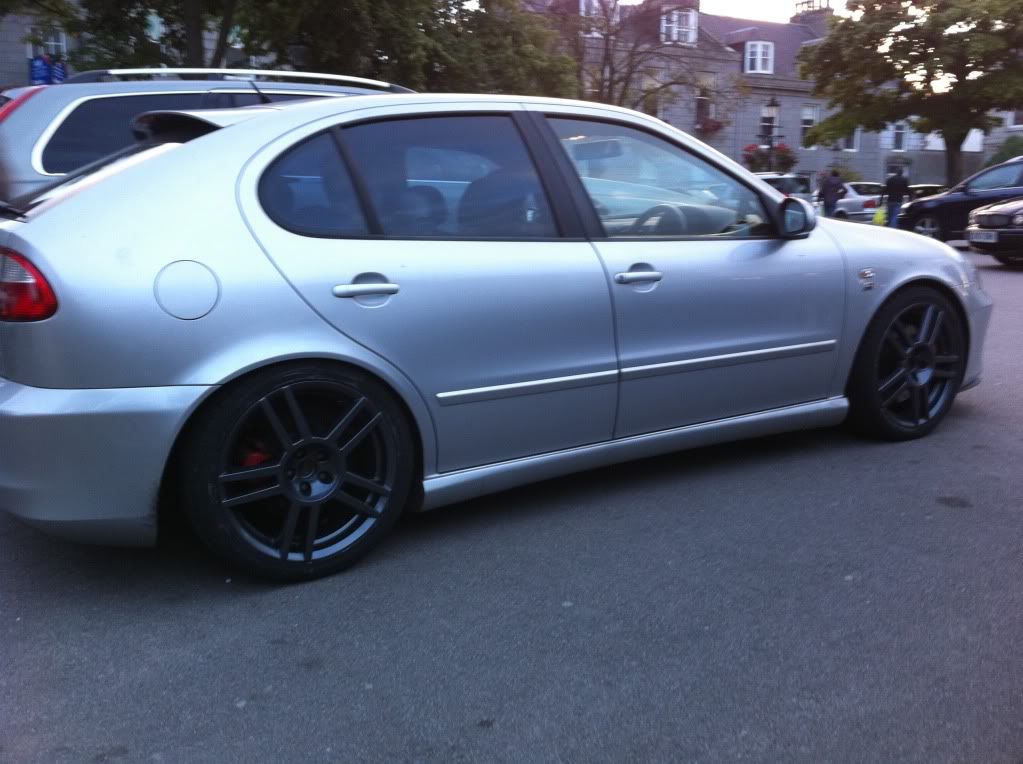

cars looking mint, was gettin upset when i thought you were selling as ive just read all the thread now hahaha.
Ok update time

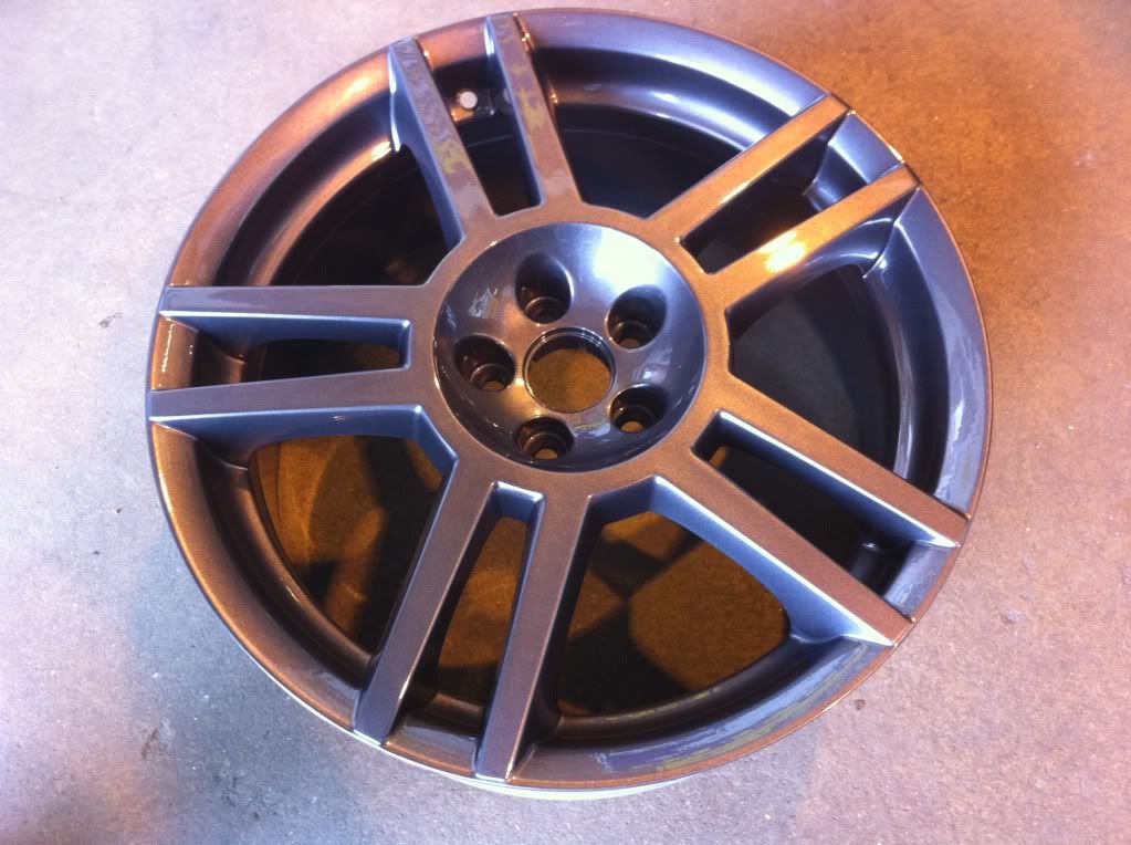

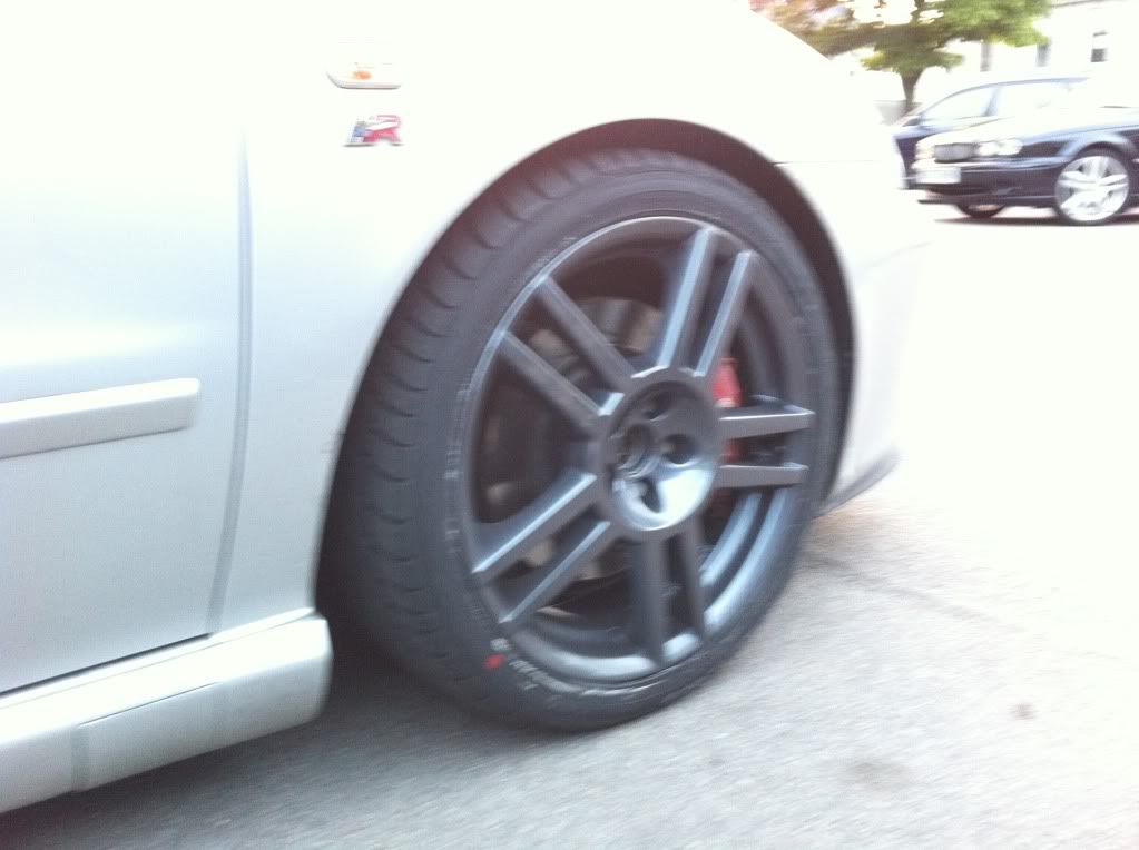

Car has been on the compomotives due to selling the lambo reps so i decided to get the lcr's refurbed and here's the results oh and was £120 for all 4 tyres off, new on and balanced

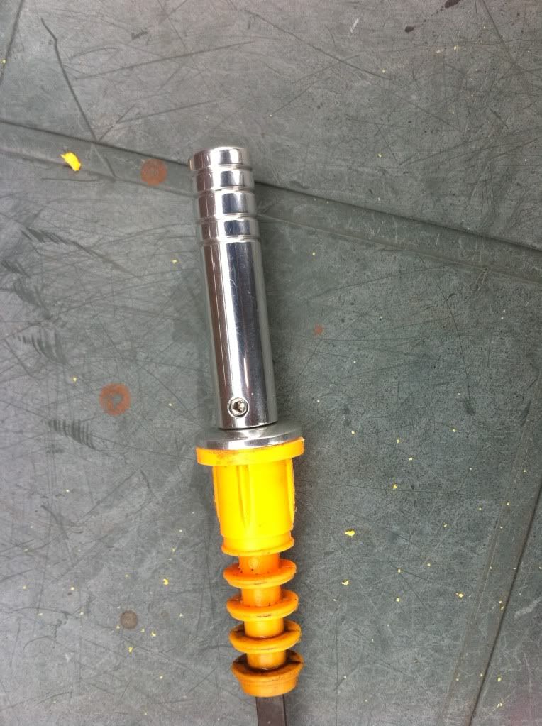

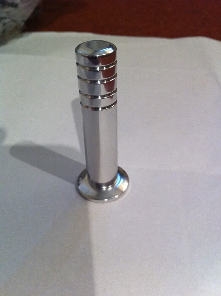

And last update i was online and came across this so though superb payed for and arrived today.
attached
In location
Thats all so far but more to come
