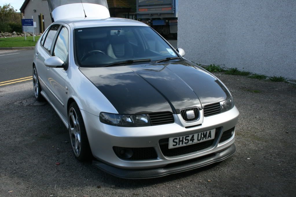

Ok guys not much of an update at the moment but been informed that my exhaust has arrived so shall get some pics up when i get home before i go and install it hopefully by next weekend. Carbon splitter provisionally bought just need to get home ad go pick it up and pay for from baz. shorter aerial bought and main thing looking at the possibility of getting my wheels re-sprayed for a nice price so question is guys....
What colour do i get my alloys re-sprayed remembering that i plan to eventuallly wrap my roof.

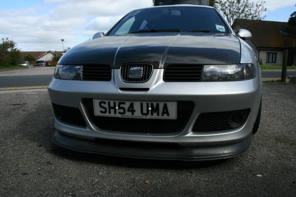

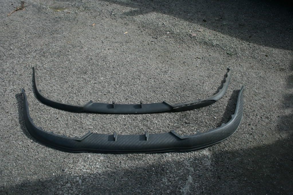

So i went and bought a carbon splitter thanks baz
Old vs New
Mock up pictures
gotta get some screws to hold in place and get it laquered to look similar to bonnet.

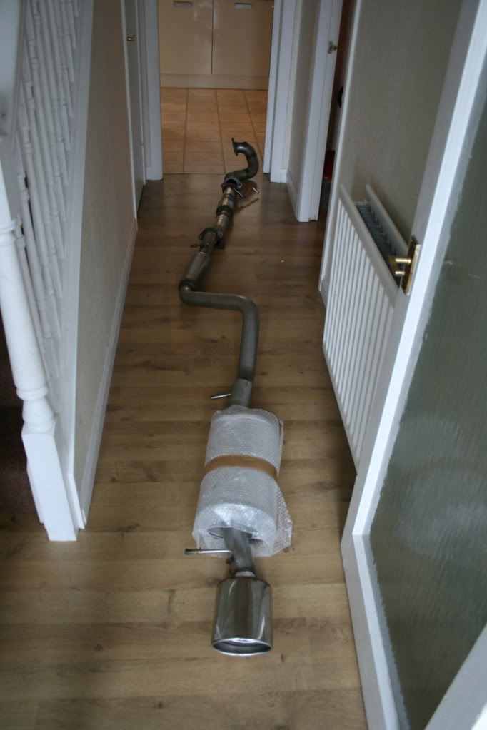

Next my exhaust arrived

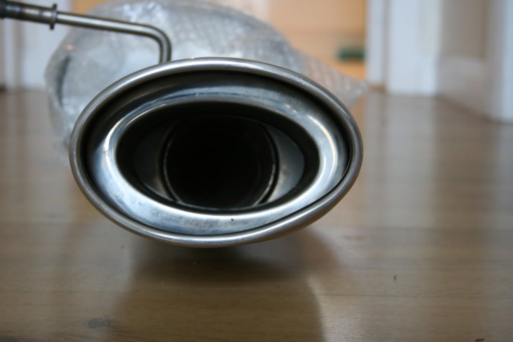

Although after inspection of box noticed this
Not to happy but have contacted blueflame so hopefully shall be sorted

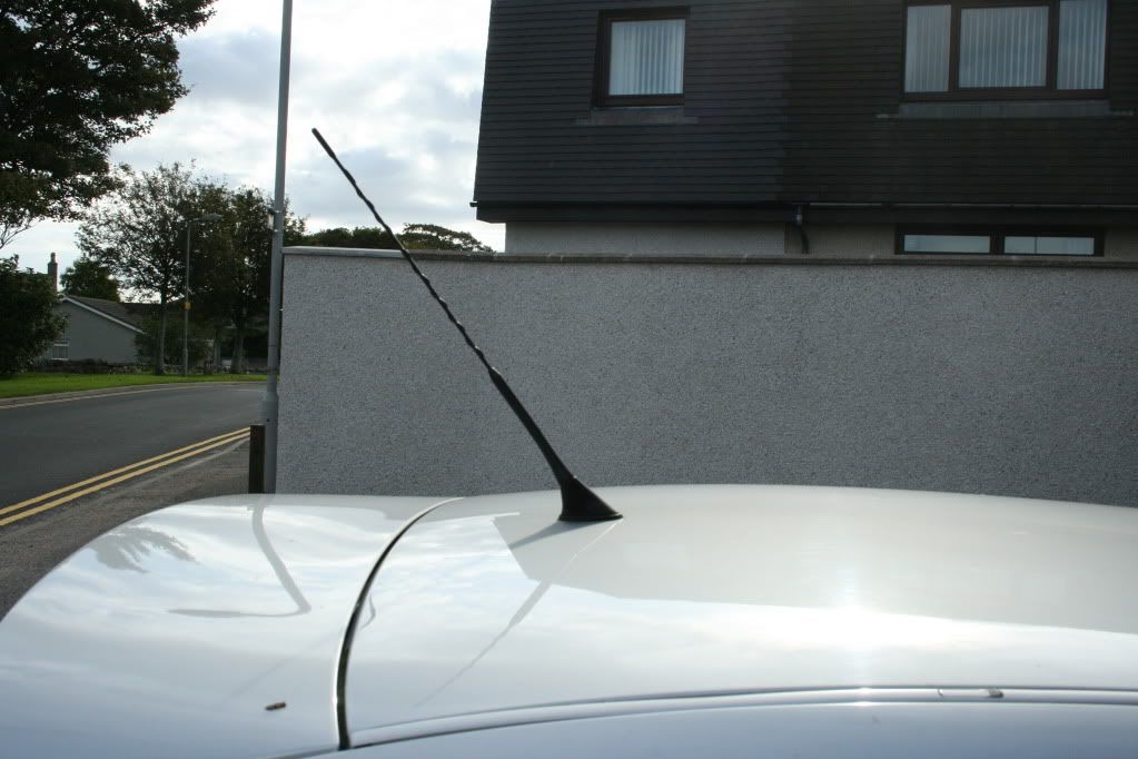

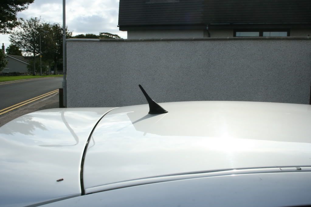

Next that daft aerial had to go so:
Old
New

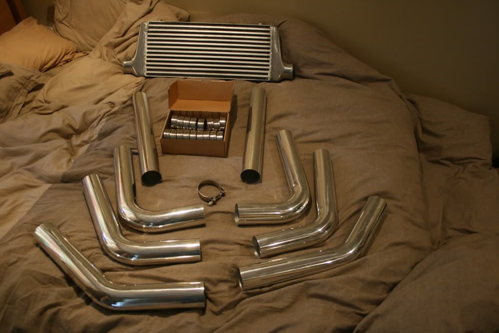

Also my intercooler has been sat so orderd some pipes and clamps:
just waiting for the rest of pipes to arrive and hoses

Broken mounting clip?
Whats happening with your exhaust?
Don't be in too much of a hurray to send this one back as long as you get your one.
BF have been known to forget about picking these things up

Blueflame called 2 mins ago about swapping it out so i predict they will take the old one soorry willie i know what your plan was :lol:.

Mark, if that IC pipework hasn't got beading round the edges remember to rough up the surface that's in contact with the hose likewise with the inside of the hose. That and decent jubilees should keep it together.

yeah baz i was intending on either getting a bead welded around or like rob has done use that putty to make a bead. Thanks for the splitter by the way picked it up tuesday

Saying that i'm sure there will be some in Aberdeen with a tool for beading tube. Aiken Sheet Metal or someone like that might know.

well i would have helped out but exhaust arrived today and the guy took the old one away.
Really supprised as to how quick that was. They said they would build it yesterday and ship same day. Just didnt expect it to be that quick.
So trip to audi garage tommorow with mate who works there to use a FREE ramp and fit it lol. Roll on music to my ear. :D

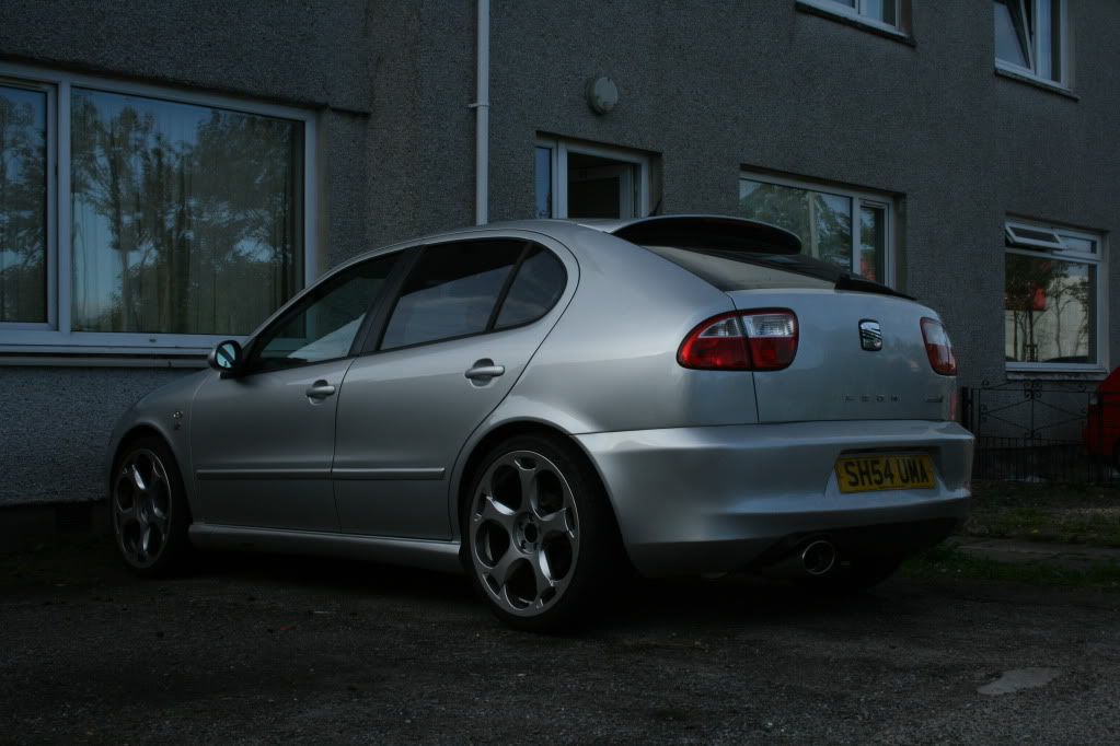

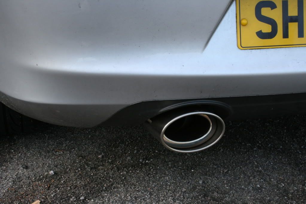

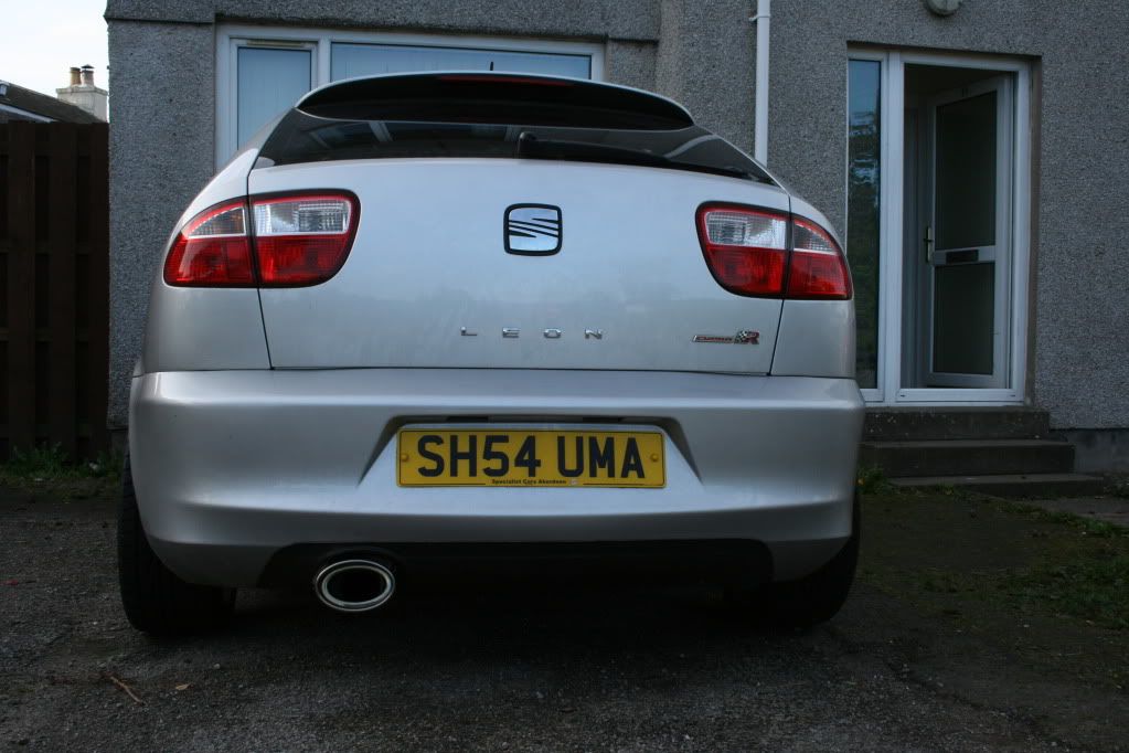

ok so finally yesterday i got fed up and decided to get the exhaust on after purchasing a gasket for the turbo to dp. Had no time to take pics as was just me. Also car was on axle stands so a little diffictult to take any but here is the finished product
hope satisfying enough the note that comes from it certainly is for me at the moment :drive1:
